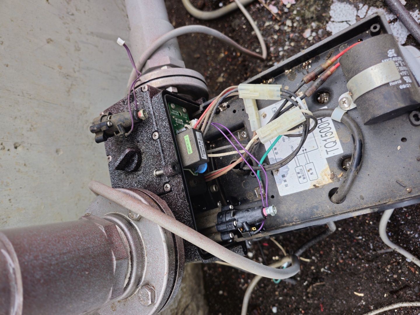

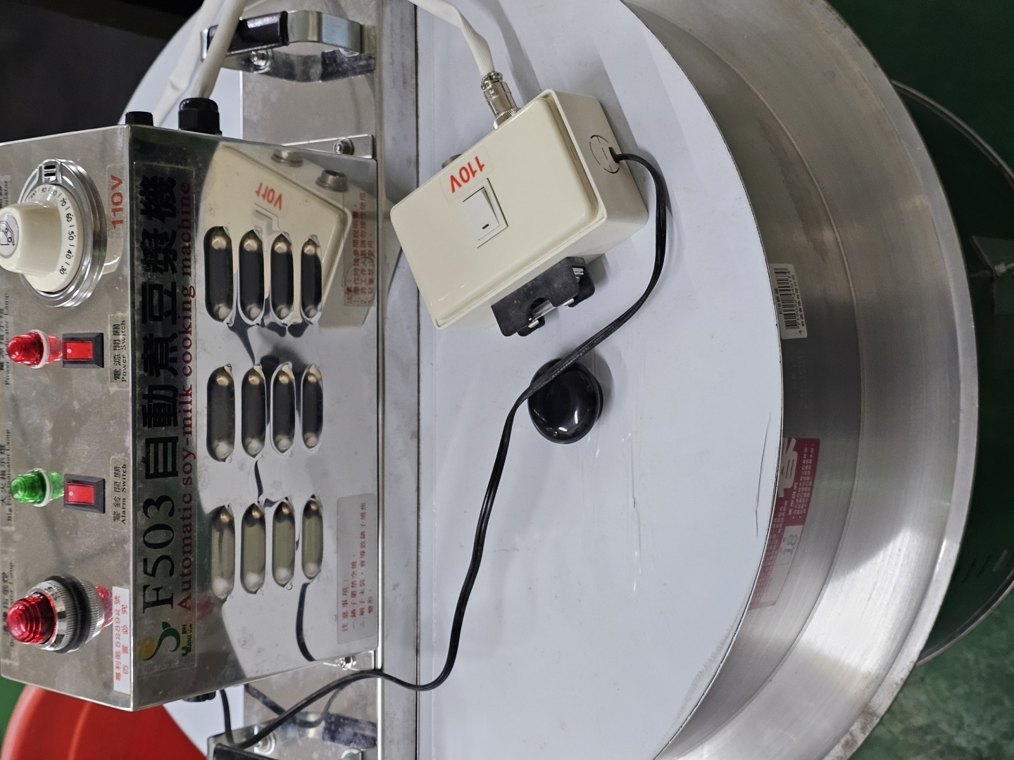

¤j¤«TQ1500H GG
ª½±µ°¨¹F¤£±Ò°Ê°Ç...
¯à´«ªº´N¥u¦³À£¤O¶}Ãö¸ò¹q¸ôªO ¨S¨ä¥L¦³ªº¨S¦³ªº
¦¹¦¸§ó´«À£¤O¶}Ãö
§¹¦¨ ¸Ñ¨M°¨¹F¬G»Ù°ÝÃD

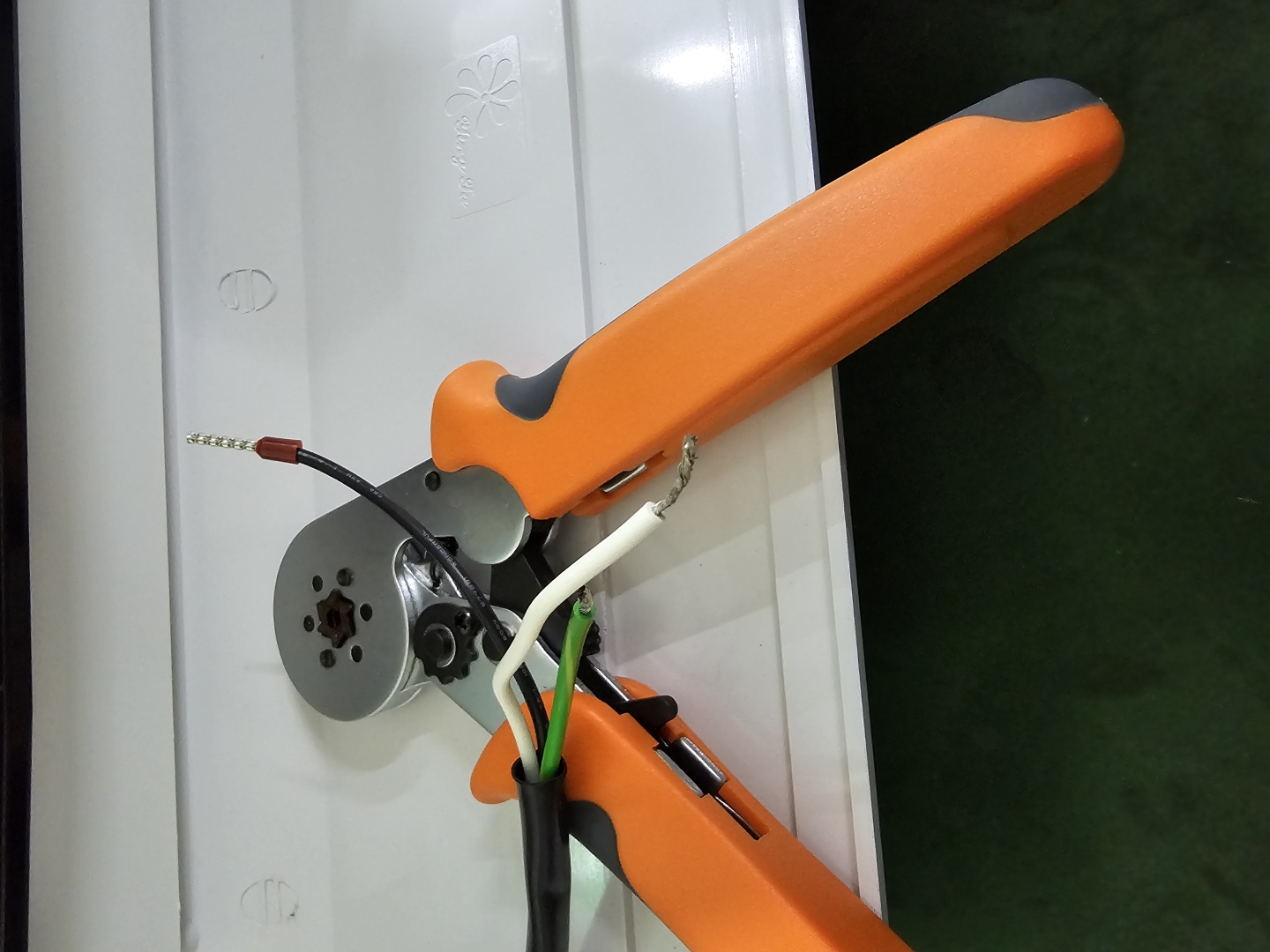

¼Ú¦¡ºÝ¤l ¯u¦n¥Î...
¥Ñ©ó¸Á»e¿@ÁY  ¾÷ªo·|°ª·Å°_·Ï ¦¹¦¸¦w¸Ë¤ÑªáªO³q­·®°
¤è«K³q­·³B²z ¤S¥i¥H¶}§N®ð
¥Î¦b³n½u¤W ´NÅܦ¨2.0MMªºµw½u¤F
¥i¥Hª½±µ´¡¶i´¡®y¤Õ

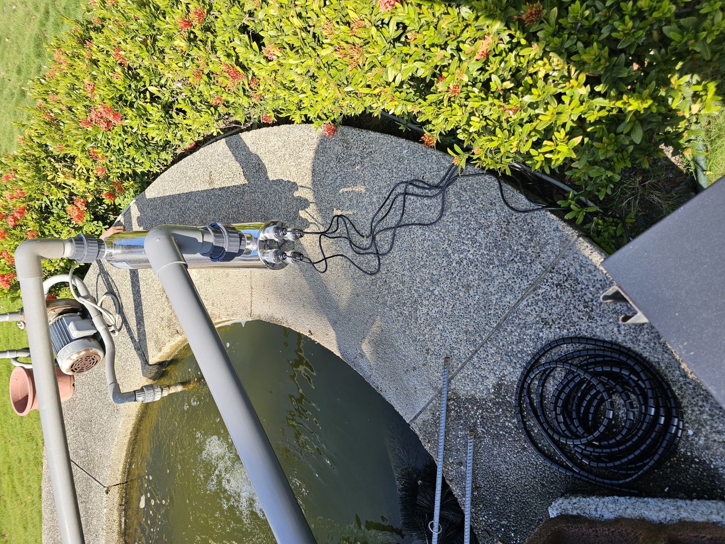

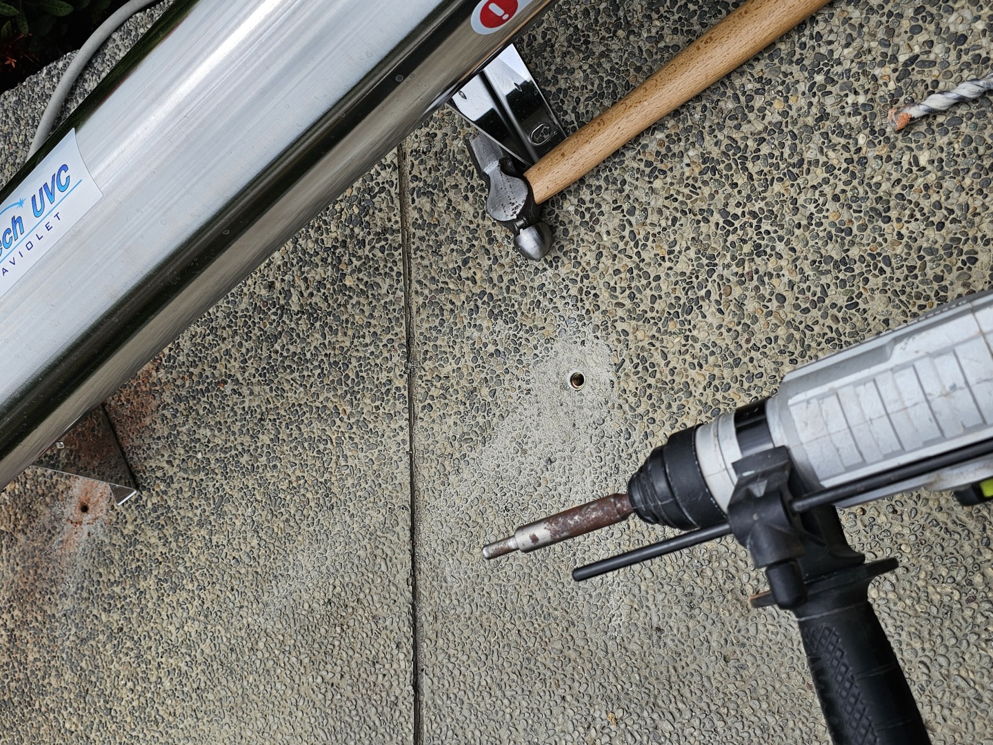

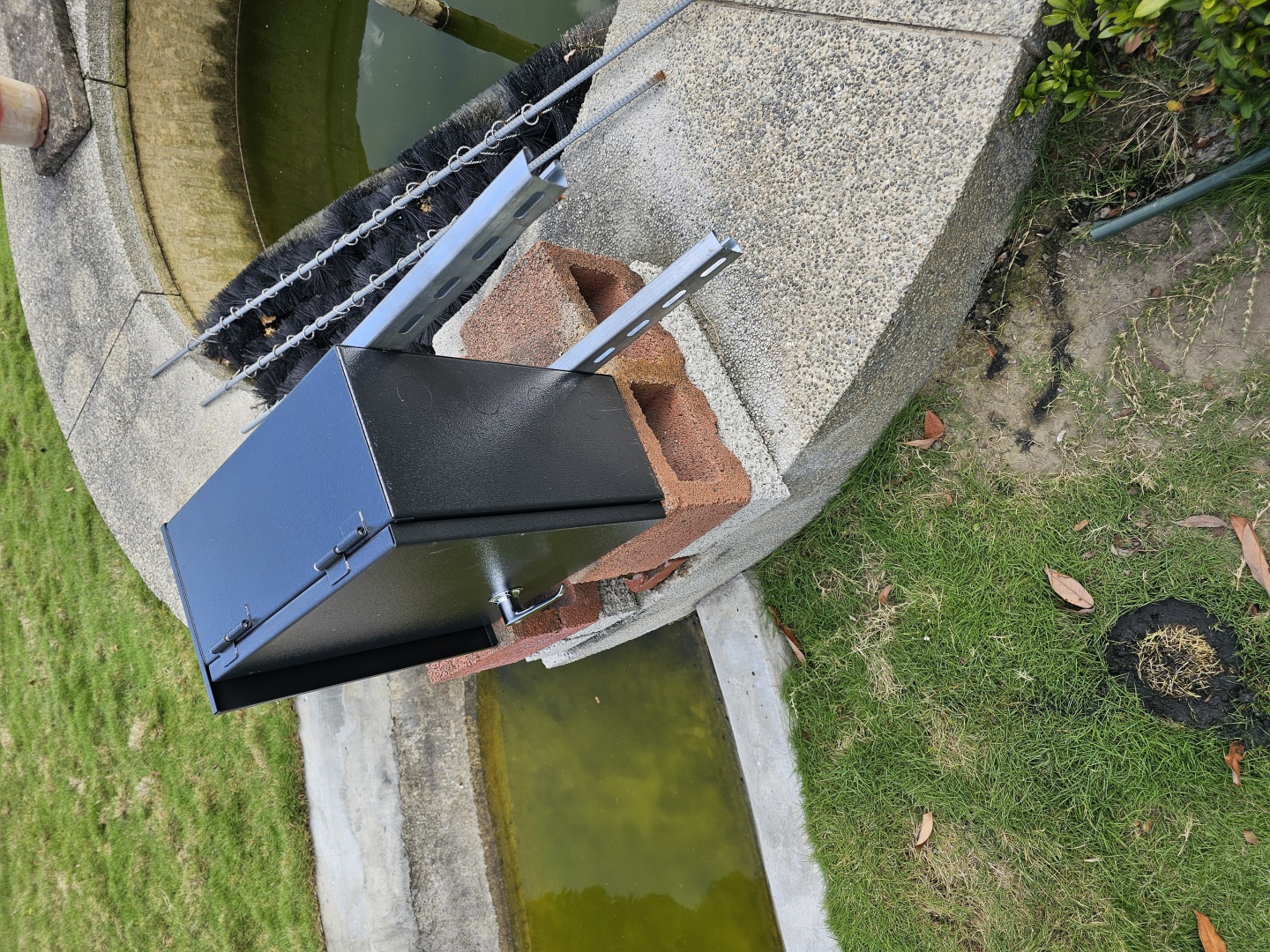

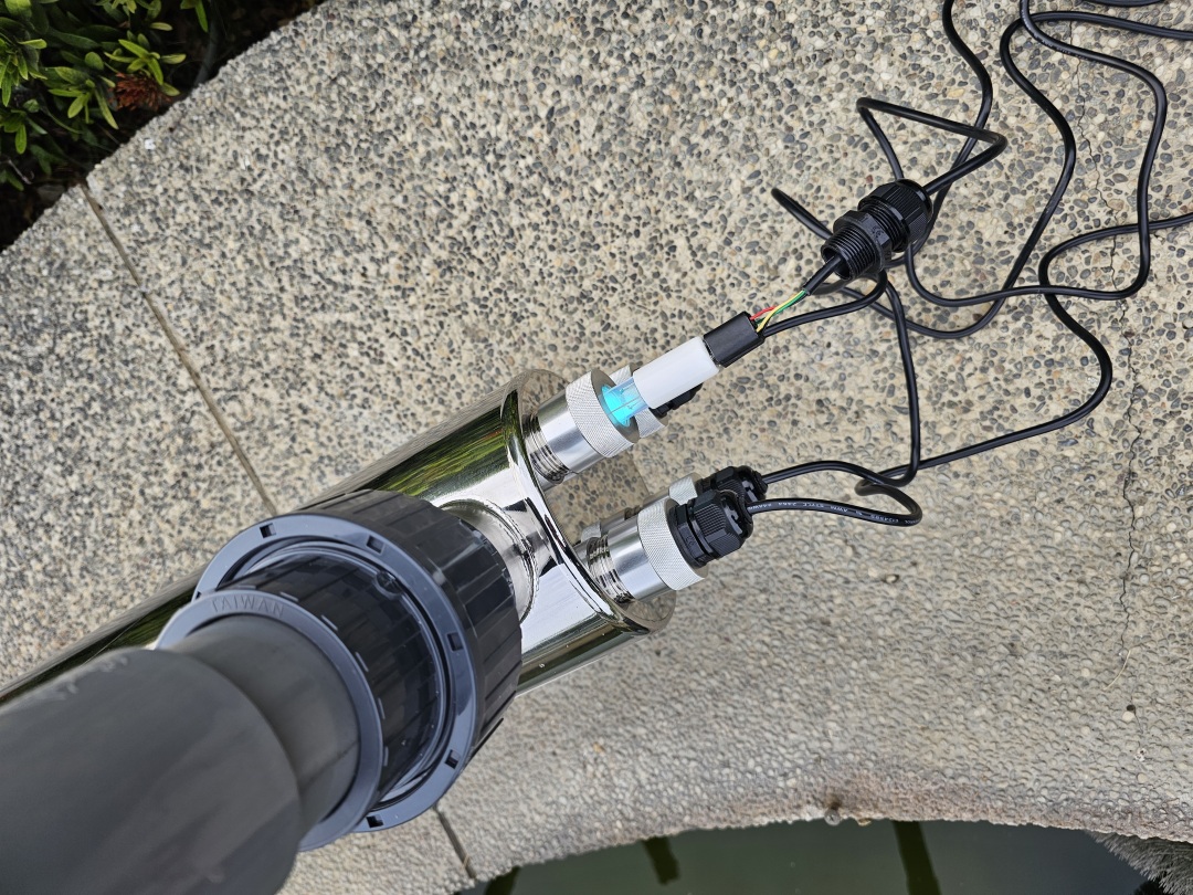

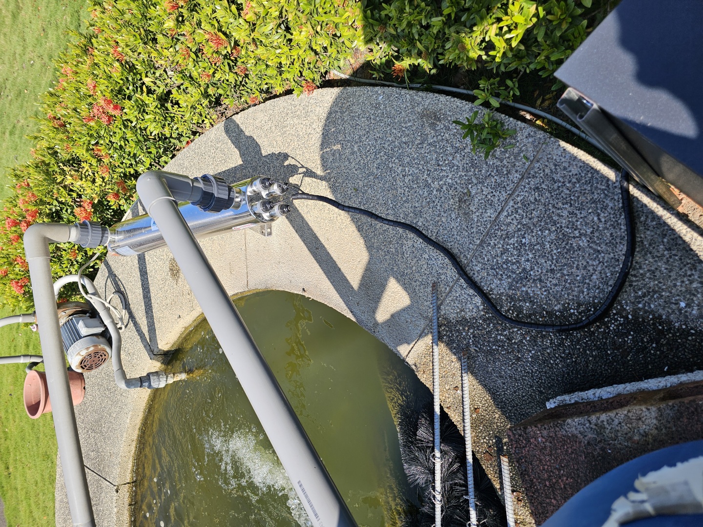

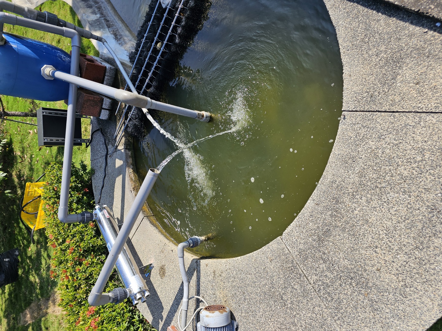

NT $7Wªº±þµß¿O...¦Û¦æ¦w¸Ë
¥DÅé´N¨º¤£ÄÿûºÞ¤l ¸Ì­±¦³¥|°¦±þµß¿O
¦³ªþ¥Ñ¥O ¸ò¶}Ãö½c¸ò©w®É¾¹
¦a¤W¥ý¥´¤Õ ¤W¾Àªê
C«¬¿û¤Á³Î
§âC«¬¿ûÂê¤W¶}Ãö½c
¤º³¡ºc³y ¨ºÅK¤ùÁÙÆZµw ºV¦n¤[¤~²æ¸¨
´¡¤J±þµß¿OºÞ
¤p¤ßª½µø
³DºÞ¦Û¤v¶Rªº ¤è«K¾ã½u
¥Ñ©ó°¨¹F¥X¤ôª½±µ¸Ë¶i±þµß¿O ¤£¨ì¤@¤Ñ¸Ì­±³£Á³ ¥u¦n¦A¸g¹L¹LÂo±í
¤£µM¹ê¦b¬OµLªk¾ã¤Ñ¦A¨ºÃä²M¨º°¦±þµß¿O°Ç...
¥Ñ©ó¤S¦h¾i¤F¶W¤jÀAÃU¤T¤Q±ø ³½¦À¤ô¦â¶V¨Ó¶Vºñ
UV¿O¤]´N¦¨¤F ¤£±o¤£ªáªº°t³Æ¤F...
¥t¥~¤S¦h¸Ë¤F¤@°ï¹LÂo¤ò¨ê
²{¦b¤ô½è¤w¸g§¹¥þ³z©ú

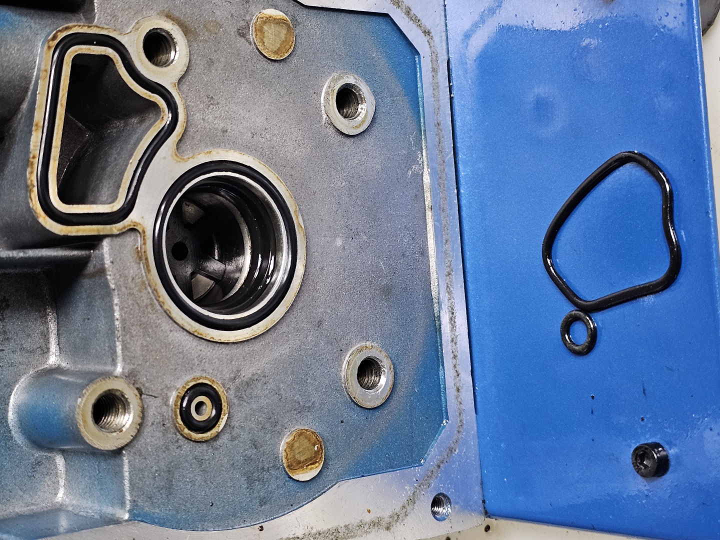

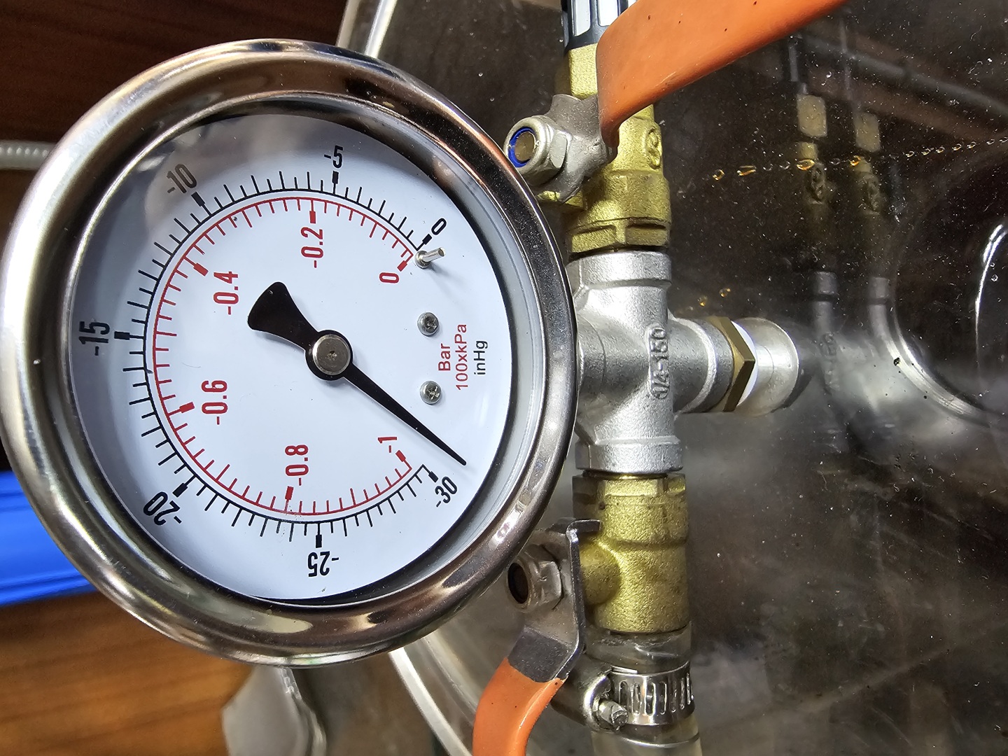

§ó´«¯uªÅ¨E®ú O-Ring
À£¤O¤£¥¿±` ³s©â¤ô¤À¤]©â¤£¤Ó°_¨Ó
¦n¦bºc³y²³æ ©î¸Ë¹Lµ{ ¹s¥ó¤£·|¶Ã­¸
¶¶§Q§ó´«§¹¦¨
¨ä¤¤¤]¬O¦³¤p´¡¦± ¸Ë¦^¥h ³ºµM¥d¦í¤£·|°Ê
¦n¦bµo²{°ÝÃD ­n¥þ©î ¤@Ãö¤@Ãö¸Ë¦^¥h¤~¯à¹ï¨ì¾¦½ü...³Ì«áÀ£¤O¥¿±`...

http://aquatech.url.tw/page3.html

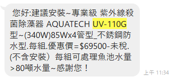

¥xÆW¥u­n¬O ¯S®íªºªF¦è³£«Ü¶Q
¦pªG­nµ¹¥L¦w¸Ëªº¸Ü ¶O¥Î¥t¥~­pºâ.....
¥Ñ©ó§Ú³o¹q½u ¦b³½¦À¨ºÃä ¦³10´X¦Ì ¤S±o§â¹q½u®I¦b¯ó¦a©³¤U
µ¹¥L­Ì°µ¥i¯à¤S¬O¦n´X¸U¤F
¥[¤Wª½±µ§â¤ôºÞ¸Ë¨ìUV¿O«á ¦³Âø½èªº°ÝÃD «á¨Ó¤S¦Û¤v­×§ïºÞ¸ô ¹LÂo±í...
©Ò¥H¦Û¤vDIY·|¤ñ¸û²Å¦X§Ú­Ó¤H¥Î³~
UV85W~¬ü°ê±M·~¯Å±þµß¿OºÞ ³æ¤ä»ù®æ=$3500-¥¼µ|
³o¿OºÞ¥u¯à¥Î¤@¦~´N­n´«¤F...¤@¦¸­n´«¥|°¦
°£«D§A¦³¤j³½¦À ¤£µMUV¿O¤£¥Î¶R¨º»ò¤j°¦ªº...
https://sites.google.com/view/dadakois
±þµß¿O²Õ
¤Ø¦T:1.5¤ØÂùºÞ
®Ä¯à:±þµß¥hĦ
³c½æ³æ»ù:110v3100¤¸
220v¥[100¤¸
¤§«e¦³¶R¹L...¤p³½¦À¥Î³o­Ó´N¦n...
