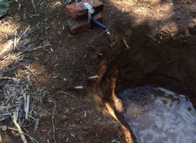

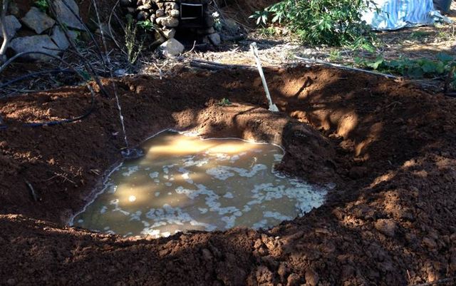

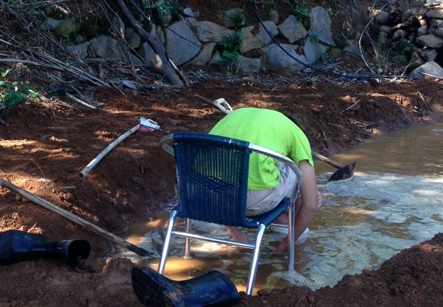

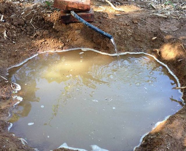

25#
µoªí©ó 2014-11-24 11:10:27 |¥u¬Ý¸Ó§@ªÌ.....¸ü¤J¥þ³¡¹Ï¤ù ¥ÎLINE¶Ç°e . ¤À¨É¨ìFB

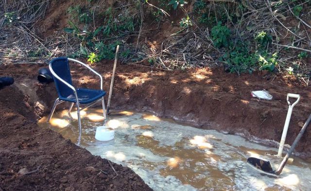

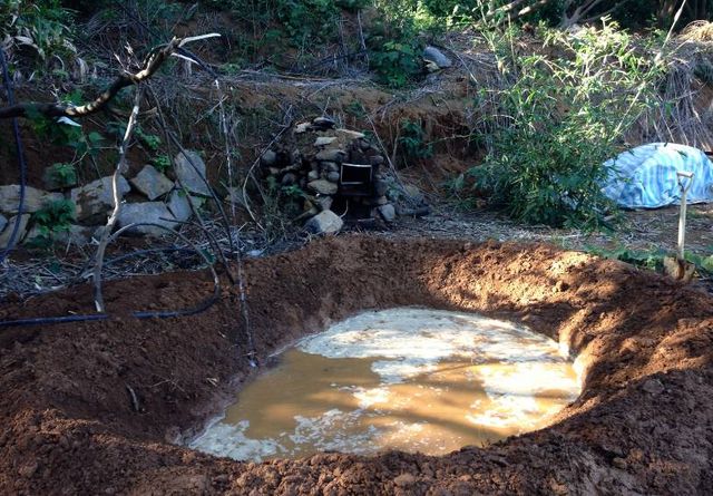

§K¹q¤O´­¤ô¾÷(©â¤ô¾÷)¸Õ°µ§¹¦¨+¤ô¦À
¥»©«³Ì«á¥Ñ chenst ©ó 2014-11-24 11:15 ½s¿è
¦³¤ô¤§«á¡A³o­Ó°²¤é¡A¥Î1970¡A2000¡A2002¦~¥X¼tªº3»O«õ¤g¾÷¡A«õ³ü­Ó¤p¤ô¦À¡C¥Î¤F¦n¦hªo¡AÂC³½¨{¤Wªºªo¡C
¶O¥Î:6­ÓÀ²°+¶¼®Æ+¨§ªá+ÄжpÂû¡C
¦n³B:§C¦¨¥»¡B¤Ö¥Î3C¡B¦h¬¡°Ê¡B+¡B¡B¡B¡B¦n³B¦h¦h
«ö³o¸ÌÅã¥Ü¹Ï¤ù
«ö³o¸ÌÅã¥Ü¹Ï¤ù
«ö³o¸ÌÅã¥Ü¹Ï¤ù
«ö³o¸ÌÅã¥Ü¹Ï¤ù
«ö³o¸ÌÅã¥Ü¹Ï¤ù
¬d¬Ý¥þ³¡µû¤À

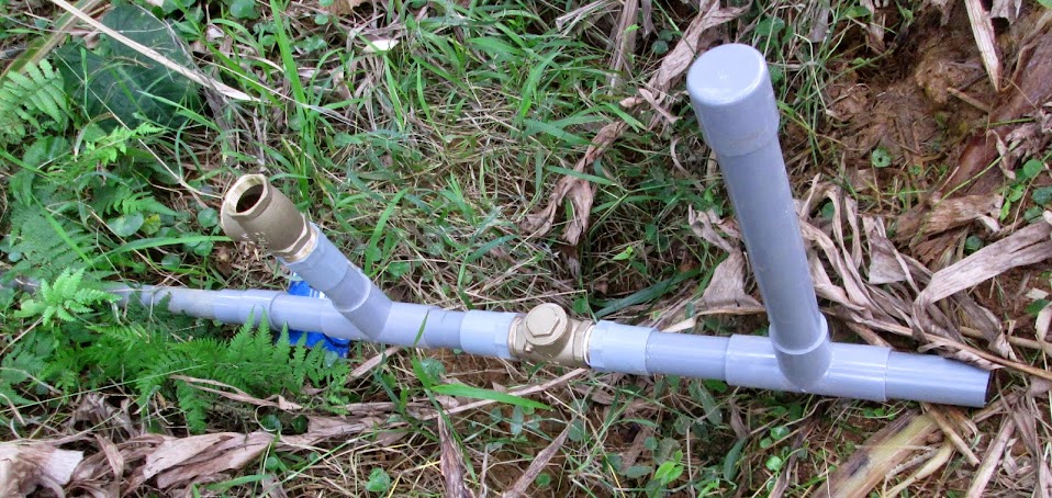

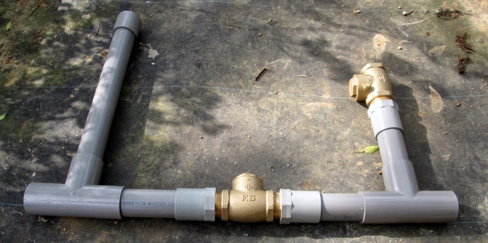

28#
µoªí©ó 2015-1-3 19:14:47 |¥u¬Ý¸Ó§@ªÌ.....¸ü¤J¥þ³¡¹Ï¤ù ¥ÎLINE¶Ç°e . ¤À¨É¨ìFB
eastern µoªí©ó 2014-12-11 22:13
¬Ý¤Fª©¥Dªº¹ê§@«á,¤âÄoÄoªº...¤]¥h¶R¤F¨â­Ó°f¤î»Ö·Ç³Æ¸Õ¸Õ...
ªì¨B²Õ¦X°_¨Ó¦p¤U,¤£ª¾¹D¬O§_»Ý­n§ïµ½ªº¦a¤è
¥kÃä¶i¤ô,¥ªÃä¥X¤ô...
¬d¬Ý¥þ³¡µû¤À
­n«ç»ò¦¬Ã¬?¥ý¨º»ò®â!
¨Ï¥Î¹D¨ã Á|³ø
29#
µoªí©ó 2015-1-12 15:40:43 |¥u¬Ý¸Ó§@ªÌ.....¸ü¤J¥þ³¡¹Ï¤ù ¥ÎLINE¶Ç°e . ¤À¨É¨ìFB
eastern µoªí©ó 2015-1-3 19:14
·Ð½Ð°ª¤H«ü¾É¤@¤U...¦]¬°¥¢±Ñ¤F!...
¹ê»Ú±µºÞ´ú¸Õ...(¤ô·½¦Û¥ªÃä¤s©Y¤§¤ô§Q·|Äéµ@·¾¥X¤ô,¸¨®t¬ù¦³¤@¼h¼Ó°ª,¶ZÂ÷¬ù¦³30M)
µ²ªG...§ÀºÝ¥¼¨£¼WÀ£,¤j³¡¥÷¤ô¸g¥Ñ²Ä¤@¥u°f¤î»Öª½±µ¬y¥X...
¬d¬Ý¥þ³¡µû¤À
¨Ï¥Î¹D¨ã Á|³ø
30#
µoªí©ó 2015-1-12 19:44:32 |¥u¬Ý¸Ó§@ªÌ.....¸ü¤J¥þ³¡¹Ï¤ù ¥ÎLINE¶Ç°e . ¤À¨É¨ìFB
eastern µoªí©ó 2015-1-12 15:40
¹ê»Ú±µºÞ´ú¸Õ...(¤ô·½¦Û¥ªÃä¤s©Y¤§¤ô§Q·|Äéµ@·¾¥X¤ô,¸¨®t¬ù¦³ ...
±zªº²Ä¤@¹D°f¤î»Ö¤Ï±µ¤]¤@¼Ë¶Ü¡H
