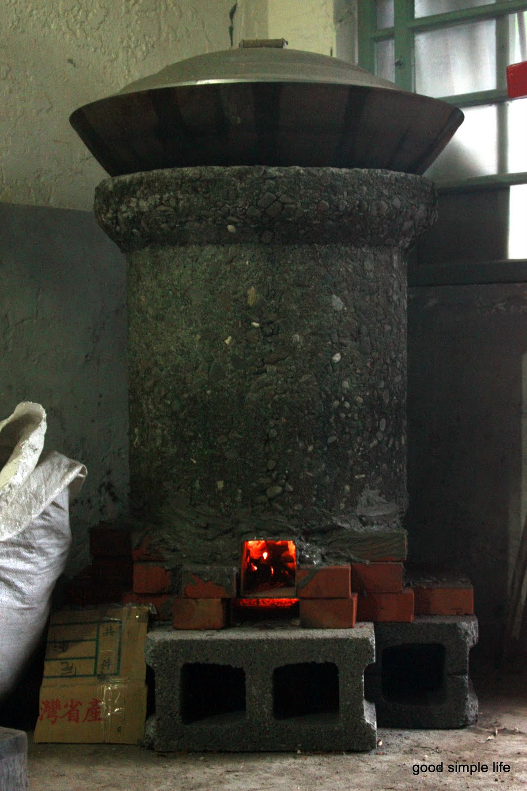

²{¦bªo¹qÂùº¦,¥¼¨Ó·|¶V¨Ó¶V¦h¤H¥Î®ãÄl,¥i¥H°Ñ¦Ò®ãÄlªº³]¤°,¥~«¬¶V½Gªø,¼ö®ÄÀ³¦n¹³¤]¶V¦n.³Ìªñ¤]·Q¥Îsiju ªº¤èªk,¥u¬O¤U­±·|·Q¥Î¨_ªº¤è¦¡³]­p,¤W­±«h¬O²¾°Ê¦¡ªº¼ö¤ôÄl,³o¼Ë´N¥i¥H¦h¥Î³~.
¹³¤U­±ªº¼o¤ôªd¤ôºÞÀ³¥Î,¤]ÆZ¦³³Ð·Nªº
¥H¤U¸êÂà¸ü¥X³B Good Simple Life
http://goodsimplelife2009.blogsp ... blog-post_2511.html
¸`¯à¤õ½b¨_
http://goodsimplelife2009.blogsp ... blog-post_4735.html
²Ä¤G¥N¸`¯à¤õ½b¨_
http://goodsimplelife2009.blogspot.com/2010/05/blog-post_25.html
